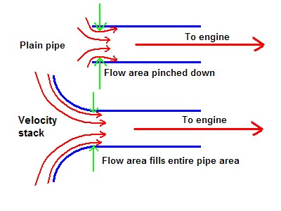

As to air flow, of course it doesn't flow well. The outlet opening is simply terrible: a flat, oval hole with rough, edges. About the only way you could make it worse is if you plugged it with a cork. I'm going to look into either fitting a proper bell mouth, or make up a new lid/outlet that does the job properly.

I'm thinking of modifying something like this:
It would have to be cut at the right angle to match so it might need to be longer. It doesn't need to be perfect to flow a lot better.

Some food for thought...
