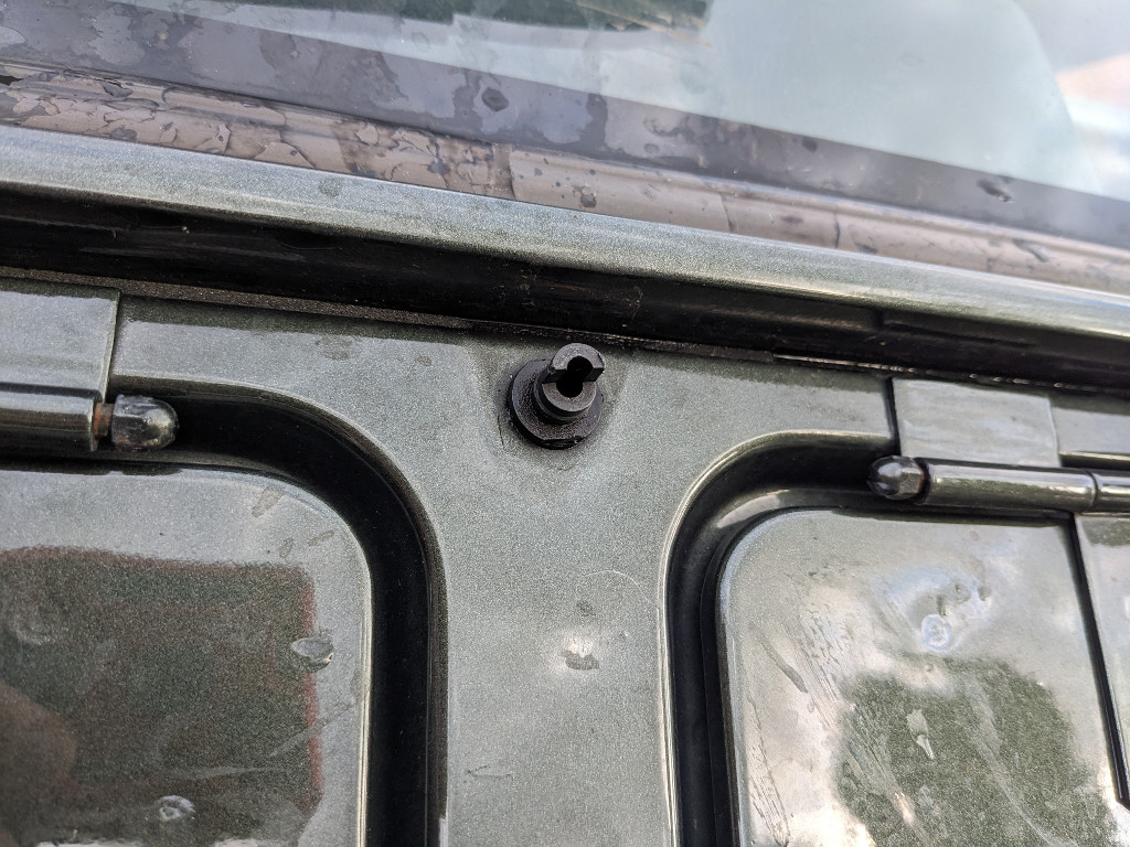

Driving back from the supermarket at the weekend, there was a dull 'thud' as something landed on the bonnet. After looking at it for a few seconds, I realised the windscreen washer nozzle had broken off - presumably due to the water freezing inside it:
I initially thought I could just push it back on, as it didn't look broken, but no it won't stay there so I assume it was originally one piece which has now split.

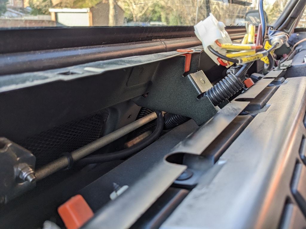

So it can't be a difficult job to replace right? Remove the top panel (2002+ Td5 interior) in the work lunch break, a little bit of extra wiring for me to remove as I have a pod gauge sitting on top:
Then you can see where the water pipe goes into the back of the nozzle:
but how ON EARTH do you get to the nut on the back of it? Land Rover in all their wisdom put a metal frame over the top of it making access ... challenging?
Has anyone got any tips beyond a total removal of the interior trim on the bulkhead to get to it from below? That's going to take a while to do... 2005 Td5 90 XS

The original nozzle is actually 2 piece so your is not broken. 1988 90 Hard Top, 19J Diesel Turbo, Shire Blue - Restoration ongoing

How does it attach then Dinnu? If I push it on, it just springs off immediately?
It looks like a single piece on LRWorkshop:
I did ponder carefully it was actually broken or in two pieces, and didn't reach a solid conclusion other than it won't go back and stay on. 2005 Td5 90 XS

But if yours is not holding, maybe it is damaged (check for cracks). I recently needed to paint the bulkhead on my puma, and did not want to mask the windscreen washer... so thought I could separate, and mask just the little part that goes through the bulkhead, but ended up shearing it from inside the bulkhead. The little self tapper was used to pull out the broken remnant.

I've not done this on a TD5 (and on the Puma you can do it through the radio aperture) but usually you'll need a deep socket on the nozzle nut after the pipe's removed.
The (crappy plastic original) nozzle is made in two parts but on neither of the two of mine that failed in this way was it possible to repair them, the first because it got run over before I could recover it and the second just wouldn't stay together. I fitted the Optimill nozzle as part of an holistic squirter upgrade including headlight washers and have never regretted it.

If you take the centre console off (the two hidden screws you revealed under the top piece and the two at the bottom. There is a plastic access panel behind the radio which allows access to the washer nozzle. Its only held on with four more screws so not too onerous. The worst bit is the top panel which you have already had off.

I cut the bridging plate between the 2 side plates off. It serves very little or no purpose. Nothing will fall off. Your dash/bulkhead will all remain in place. It won't be the end of the world. It won't make a scrap of difference to climate change.
If you're really anal about this sort of thing though, you can always make up a replacement plate that either pop rivets or screws on.
