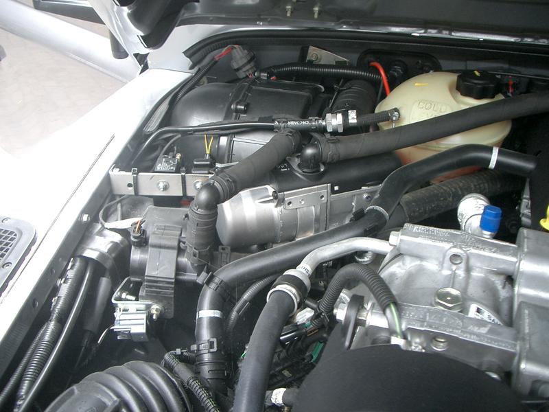

Matzker puts the heater on the same place like naka, but without having problems from the airintake:
https://www.matzker.de/defender-standheizung.html
Here you can see the two options, recomended by Webasto:
https://www.offroad-forum.de/pserv.php?img...8335zy.jpg
https://www.offroad-forum.de/pserv.php?img...8334oa.jpg
Here we have the mounted to the frame option, which I think is not the best solution:
https://matsch-und-piste.de/wp-content/upl...erbaut.jpg
And then there is the option to mount it into the right front fender, behind the headlight. Right now this would be my preferd place.
Finally I found some pictures (maybe you have to log in... Rolling Eyes )
https://www.blacklandy.eu/blboard/vb5/node...post579964
https://www.blacklandy.eu/blboard/vb5/node...post580723

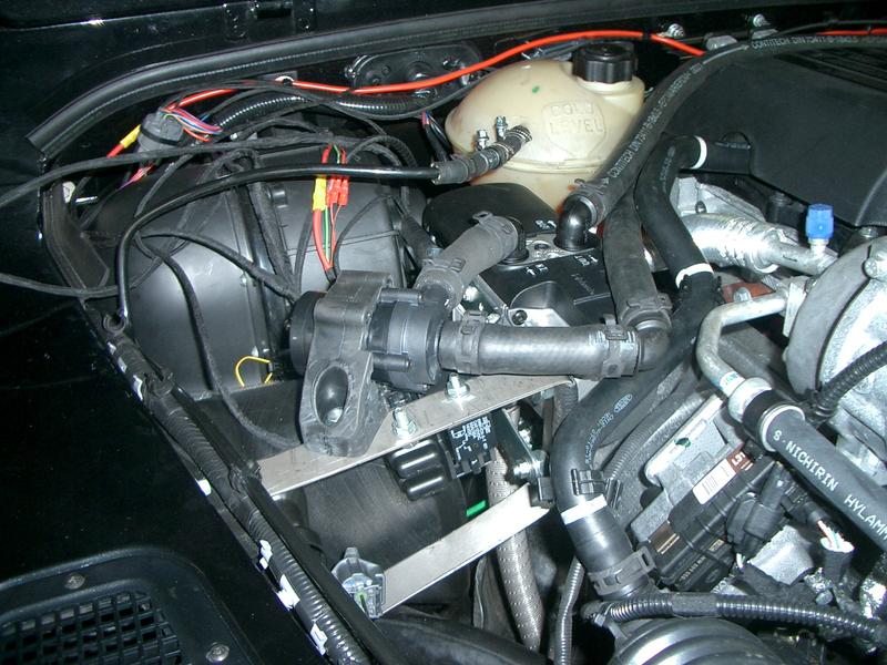

So in case you´re a real human Whistle , here is one of the pictures:
I´ll have a look under the bonet the next days, right now it´s too cold...
The rear wheel arch is an interessting idea, never thought about it.
A nice sideeffect are the warm exhaust gases coming from the 5D which could be used to warm up the Diesel filter.
