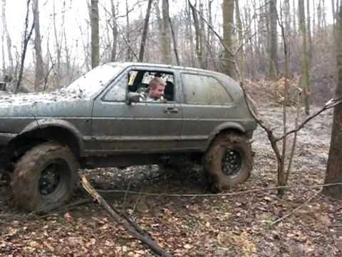

Posts: 6073
pumaxs wrote:
In the interests of balance, I will post on a more relevant forum that my Golf GTI has pi$$-poor ground clearance & is rubbish at crossing muddy fields! Laughing
I wonder what the response will be? Rolling with laughter
Dons tin hat! Whistle
One of these?
or even:
Rolling with laughter Rolling with laughter Rolling with laughter

Theres an idea!
I could put the Defender body-shell on the Golf chassis, & the Golf body-shell on the Defender chassis, and have the worst of both worlds! Wink
Wheres my angle grinder!? Rolling with laughter '57 Defender 110 XS Station Wagon 2.4tdci
