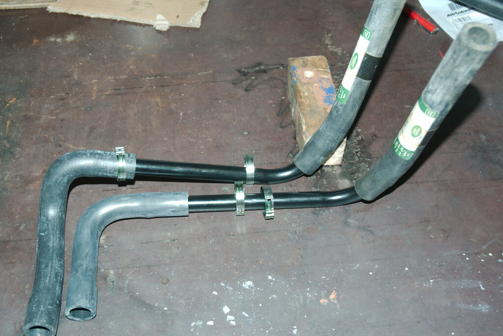

So far so good, now onto the top tubing for the heater matrix. I present you with exhibits AWR6631 and AWR6632 :
along with ERR5474 and ERR5473 (not shown here)
and all the parts shown in the diagram for:
https://www.lrworkshop.com/diagrams/land-r...ipes_52990
A minor problem came up where the LRW lists the bolt for the mounting bracket as part number:
SH605071 - 5/16" UNF x 7/8"
but this is far too small to fit the hole on the back of the engine, assuming I'm trying to plug it into the right place (I can't see how it can be anywhere else). The thread on my head is a 3/8" UNC. I don't know if the listed part number is just wrong, or I have an odd hole size.
I've only got a 2" length bolt in the stash, so this will have to get changed for a more appropriate bolt at a future date.

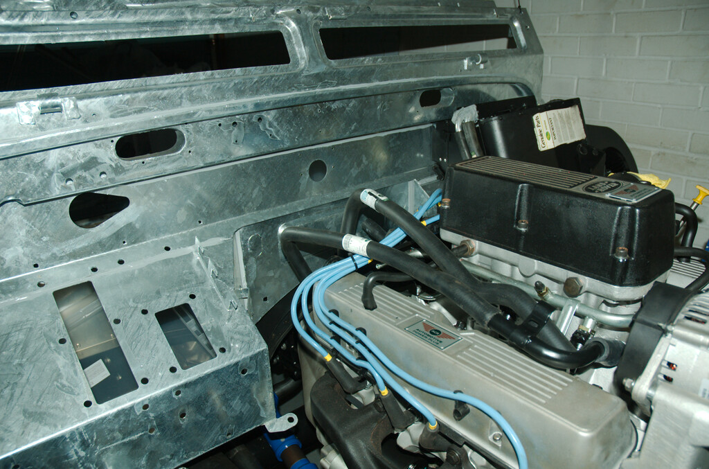

After fitting the assembled pipework, it became evident of my mistake number one. The pipes AWR6631 and AWR6632 replace the two L-shaped pipes shown in the diagram Embarassed
These L-shape pipes only run half way across the engine, which if my memory serves me is where they would have been on the original 3.5 engine, where they plumbed into the top of the V. Oh well, not too an expensive mistake (yet).
Next up, the stubby pipe which attached the shaped metal pipe to the water pump housing:
That fits fine, but then we run into the bigger problem. How on earth does the longer metal pipe fit?
If we refer back to the 50th Anniversary model:
this pipe should sit behind the alternator somehow, to drop down to the lower hose connection? Well I can't see how this can possible fit on mine, there is no room to drop the pipe behind the alternator? Have I missed something obvious here? I don't see any alternative than attempting to fabricate a pipe to run down the outside of the block Confused
Finally, fitting the two longer top heater matrix pipes seems a little unsatisfactory, are they really just supposed to flop free on top of the plug leads like this?
